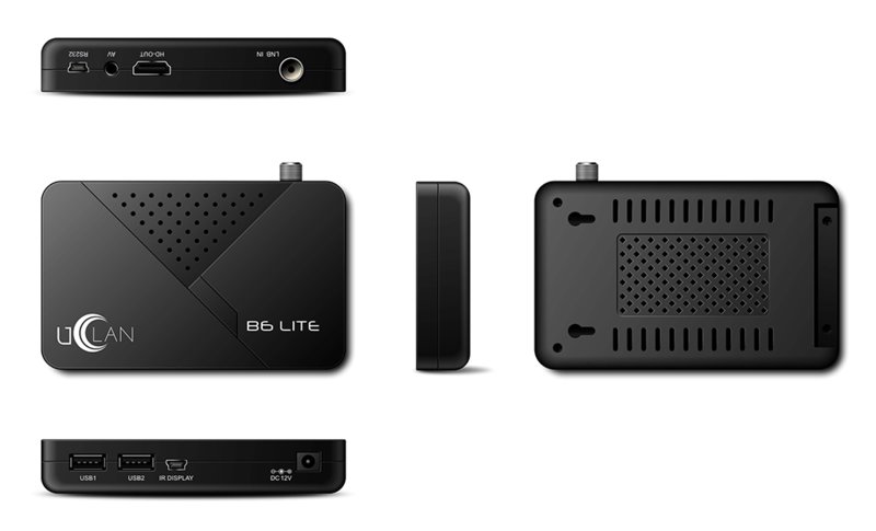

B6 LITE - обновленная версия самого популярного спутникового приемника uClan B6
The updated, with affordable price B6 LITE acquired a display on an external IR sensor and a card reader. In addition to the low price, device is playing channels with good image quality on both SD and HD channels, as well as high sensitivity of the receiving path of the input tuner.
It should be noted that the receiver can be used as an IPTV / OTT set-top box, links to playlists and playlists themselves can be downloaded from USB media, in .m3u and .m3u8 formats locally or from the cloud sources.
There is support for the most popular types of USB-Wi-Fi adapters (5370/7601 chipsets), support for USB-3G modems, USB-LAN adapters (88772B, SR9800, SR9700, RD9700, RTL8152B, RTL8153) and Dolby Digital AC3 . Multistream streams are scanned and work without problems.
Despite the compact dimensions of the tuner, the developers managed to avoid overheating of the device. The manufacturer also provided for a "hidden" installation of the receiver, for this there is a corresponding mount in the delivery set and a remote IR receiver with a display.
The receiver is equipped with a CONAX card reader (Crypton system is also supported).
It is also important that the remote control is compatible with other models of uClan satellite receivers: Denys and Ustym 4K
